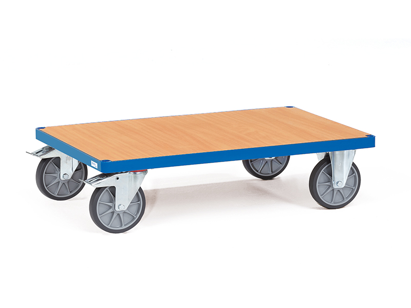

Perhaps you can get it onto a trailer using something with bigger wheels than a trolley jack. Something like this:
They are quite expensive so see if you can hire one.
https://www.theworkplacedepot.co.uk/trucks-and-trolleys
Unless you have other uses for a tow hook later, it would probably be cheaper to rent a car with a hook (and even a driver).
