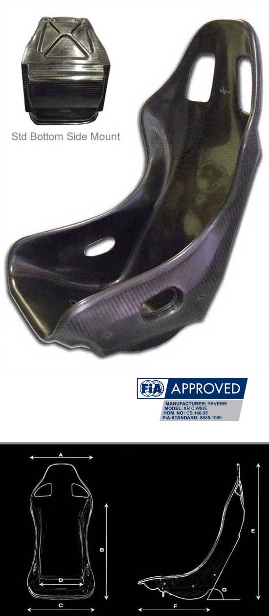

What about this one !?!
Dimensions (in mm):
A: External max width at shoulder = 550
B: Seat bottom to mid shoulder = 600
C: External max width at base = 490
D: Inside max width at hips = 355
E: Max height = 900
F: Base length (approx) = 470
G: Back inclination (degrees) = 75
Mass: 4.9kg!
Fully FIA tested & approved
http://www.reverie.ltd.uk/product_detai ... =R01SI0045
Christian.

Hi
I am running elise seats in my road going elan - really comfy and come with head rest built in AND they clear the rear roll hoop and I am 6'1"!
In the modsports car I am building I am using the tillet carbon seat that I got cheap. Its the one where you are virtually lying down (like the Reverie one but more laid back). We fitted a frame for it so the rounded bottom is at floor level and I end up looking through the bottom of the screen.
Not sure if it will help or not but it expands the debate.
I'll try to attach a photo of the elise seats
Good luck
Gavin
