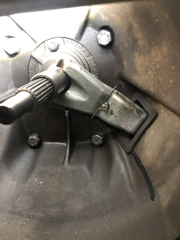

As has been pointed out by someone more observant than me (my old man) the retaining clip that holds the fork to the pivot pin is missing in this photo so presumably this wasn't fitted? That could cause you problems when jiggling the engine into position such as something getting displaced.

If you enlarge the photo, the clip is still there.

The clip is definitely still there. My original picture did give the impression it might be missing.

Mazzini wrote:Hey Al,
Good talking to you yesterday. Thanks for your advice.
Cheerio,
Rob
Eyup Rob, thanks for calling. Always good to chat. Glad to hear you think of me for advice even though I didn't help, and I cut you off early for some snap!
I blew that photo up before I made the post and still didn't see it! Thanks for clarifying!
Glad to know it's there! Sorry to cause you worry! When you refit the engine to the gearbox the best method is to make sure that the fork and bearing are sat as far back towards the gearbox as possible so as not to disturb it when getting the engine fully into position.
