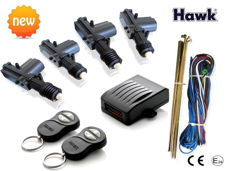

Keith,
I can't help you with specific pictures, but there are lot's of universal remote central locking kits out there at evry reasonable prices. Take a punt at ?20 and make it work, looks like they fit most applications.
http://www.ebay.co.uk/itm/UNIVERSAL-REM ... 0375507292
