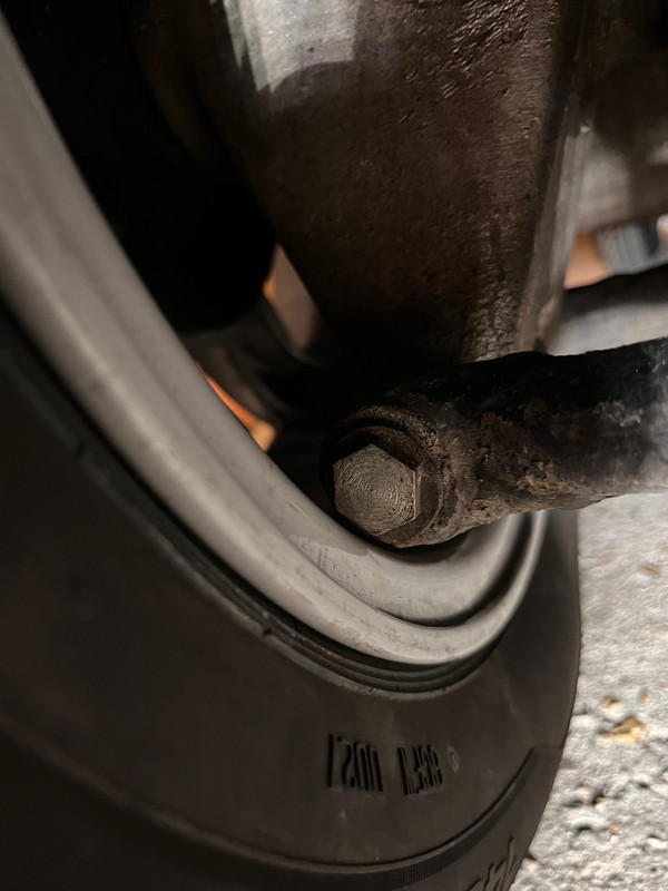

Just took some time to watch what's going on, it also gives me the chance to get to know this car a bit better.
And here are my thoughts, i see 2 issues:
1) The wheels on the car are 13-inch minilites, 5 inches apart.
The original rims (which I also have) are also 13", 4.5" offset, except if i am mistaken
The inside of the minilites fit far too close to the wishbone nuts.
The result is that the inside of the rims rubs quite deeply against the nut and/or the wishbone. This could explain the noise that can vary according to the speed and camber.
I am thinking about reinstalling the original wheels as i don't want to cut/sand the bolts and/or wishbone for more access

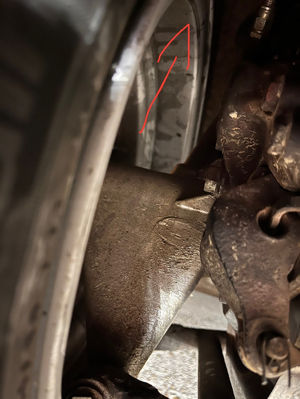

2) The handbrake pads seem to me to be much too close to the disc. Here's a photo without the handbrake on!
Is the adjustment done at the level of the centralizing clips?

If the bolt or housing is contacting the wheel with that much clearance, I would be concerned about the integrity of the bearings or the fit of the bearings in the housing. Suggest carefully checking runout of the stub shaft/hub assembly as well, possibly a bent wheel?

At some point I tried to fit alloy wheels to my stock '68 Fed s4se, and clearance has proven to be a severely limiting factor : in the end I only managed to fit reasonably Dunlop 4"1/2 (NOT the 5"1/2 fitting plus2s), with all the fettling I could do to accomodate 175x60 13 (Yokohama for track days). Same tires dimension would fit just fine on the original Lotus steel KO rims.
Regarding the lower rear suspension frame, even with new bearings precisely adjusted etc., the clearance is rather small (only a couple mm), and with stick tires the deformations may cause rubbing in case of insufficient clearance or too much play in the suspension under load.
If you are set to keep alloy wheels (I did not want to overstress my stock rims with sticky compound on the track) then you may want to overhaul your rear suspension, and if required possibly increase clearance by *slightly* machining the offending angle of the two rear minilitesr (std disclaimer: have the machine shop check carefully metal thickness prior machining, and use modified wheels only under complete understanding of risks and consequences on the track or elsewhere). Good luck !
keep it on the road...

'I've seen the following note on the TTR website concerning the minilites :
YOU MAY NEED TO MAKE SOME SMALL ADJUSTMENTS TO THE INNER WHEEL ARCHES TO INCORPORATE THESE WHEELS'
If anyone suggests altering the bodywork on ANY Lotus so that their part will then fit, trust me, you are dealing with the wrong company and buying the wrong parts.
'I am thinking about reinstalling the original wheels as i don't want to cut/sand the bolts and/or wishbone for more access'
That is the best suggestion you have made. If you do not have tyres fitted to those rims at the moment, make sure you get them checked for trueness, cracks, other defects, enlarged locating holes, before having new tyres fitted. ONLY fit the original size tyres.
'The handbrake pads seem to me to be much too close to the disc'
There is only supposed to be a few thou of an inch clearance, 3 I think, when the handbrake is released, between each pad and the disc, but if your rear brake caliper was all in good order, it would not matter if there was 0.020" clearance, the handbrake would work perfectly well. Nobody actually measures with feeler gauges, the clearance, I certainly do not and never have done, and the handbrakes work as intended on all my cars. You just have to ensure that there is SOME clearance between the friction material and the disc. Some people put a spring on the rod with the eye, to hold off the pads, but there was never one fitted from the factory. I have cars fitted with a spring and without, but it makes no difference if everything is working properly.
'Is the adjustment done at the level of the centralizing clips?
No, if you look at your picture showing the handbrake pads, the adjustment is carried out at the end of the rod with the eye, where there is a serated nut, and there should be a clip type thing that stops the nut from turning of its own accord.
From the pictures you have posted Niklas, your rear calipers, rear suspension, bushes, bearings etc. look very tired to me, and if that was my car, I would rebuild the whole lot. That would be the only way that I would have confidence in the rear of the car.
All the best,
Leslie
- 512BB
- Coveted Fifth Gear
- Posts: 1075
- Joined: 24 Jan 2008
- Location: Cambridgeshire, UK
512BB wrote:'I've seen the following note on the TTR website concerning the minilites :
All the best,
Leslie
Thanks Leslie,
All of this makes sense, and thanks again for sharing those elements.
I was a bit surprised though about the fact that calipers, suspension, bushes, bearings etc need to be replaced. What drives you to say this? (again, i'm discovering this car, so please forgive the basic question here)
The shock absorbers, bearings were changed recently so i'm just wondering why those parts shall be changed now.
Cheers,
Niklas
