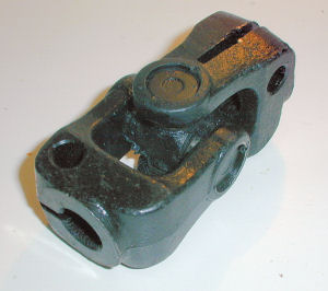

Given you are in the US, this might be relevant. I replaced my worn stock coupling with a U-joint from Dave Bean and was unhappy with the results. It’s a folded steel design that didn’t get sufficiently tight around the splines of the rack and steering shaft resulting in some slop. It's not clear if they are all like that, or if I just received a bad one, but I didn't want to take a chance so replaced it with a slightly more expensive, but much stouter, cast version from RD Enterprises (see pic). It works great.

JohnCh wrote: It’s a folded steel design that didn’t get sufficiently tight around the splines of the rack and steering shaft resulting in some slop.
-John
even when you tighten the "fold" with a screw (absent on your photo)?
might there be an issue in spline shaft diameter then ? this kind of design usually works well ...

That photo earlier is the one from RD that works. The Dave Bean version looks more like this. It's folded steel and even with the bolt cranked all the way down, there was still some slack. Granted it wasn't a lot, but it was noticeable. Bottom line, the slightly more expensive version from RD works great

JohnCh wrote:That photo earlier is the one from RD that works. The Dave Bean version looks more like this. It's folded steel and even with the bolt cranked all the way down, there was still some slack. Granted it wasn't a lot, but it was noticeable. Bottom line, the slightly more expensive version from RD works great
-John
are you sure the slack was coming from the joint/column junction (and not for example from the U-joint ) ? I would imagine that one canno't tightened it "all the way", that is there should still be a gap remaining between the two sides being tightened when they come in contact with the column: such a design mistake would be surprising from Dave Bean...

nmauduit wrote:are you sure the slack was coming from the joint/column junction (and not for example from the U-joint ) ? I would imagine that one canno't tightened it "all the way", that is there should still be a gap remaining between the two sides being tightened when they come in contact with the column: such a design mistake would be surprising from Dave Bean...
Positive. I placed my hand on the joint while turning the column to feel for the play. By tightened all the way down, I meant torqued down to the point that the opening wasn't reducing any further and it was difficult to tighten the nut any more without going to a 1/2" drive or breaker bar. As noted earlier, I could have received a bad part, or the tooling used to make mine was at the end of it's life resulting in tolerances that were sufficiently large that slack was evident with my 50 year old splines. Regardless, the joint from RD worked perfectly, and the one from Dave Bean did not.

I would note that TTR sells both types.
At the time I bought mine they only offered the one that JohnCh complained about. I found no problems with it unlike JohnCh. No slop. Might have received a bad one from Bean.
