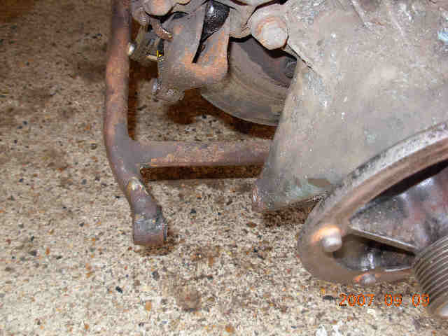

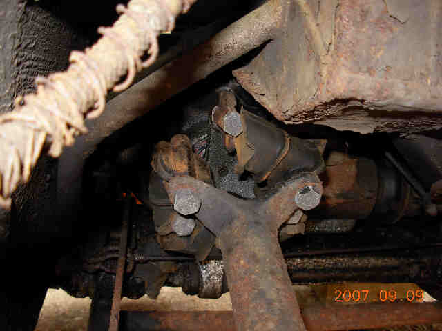

I did my doughnuts again Sept (2007) and now have a new technique to make it easier.
Remember in the final assembly ALL bolt heads are OUTboard.
trestle

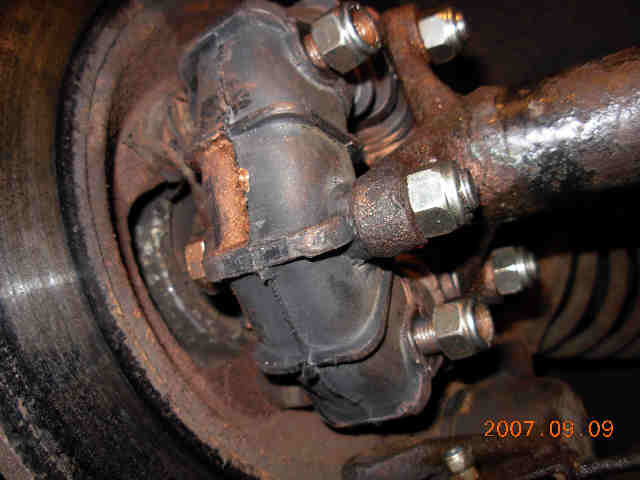

broken doughnut. Terrifying!
prepare halfshaft

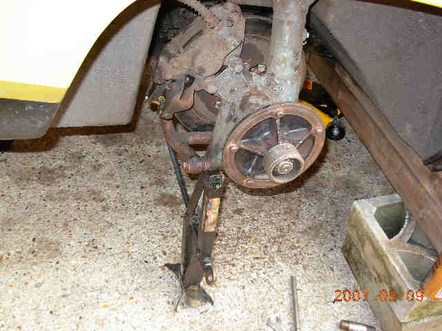

release bottom of suspension
twist suspension to more easily get old doughnut off and new doughnut on

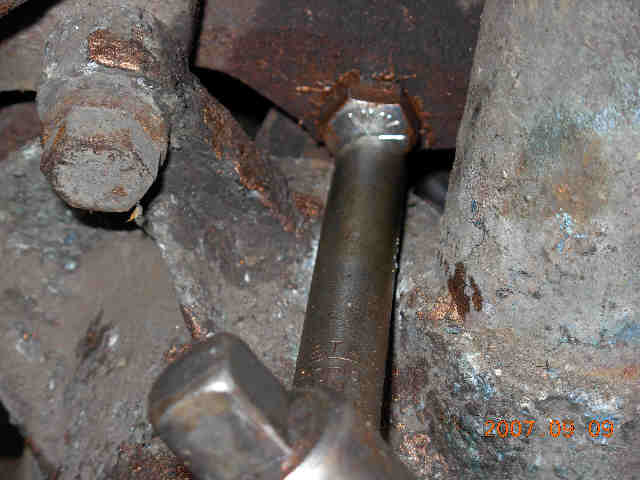

Tap in brake disk bolts

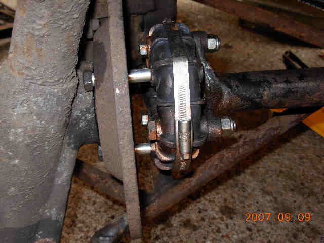

brake doughnut fitted but still loose

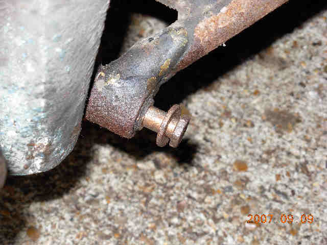

reattach lower suspension
jack it high

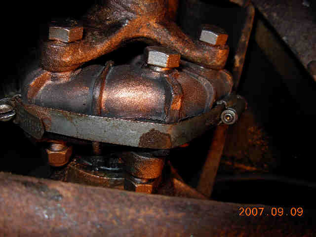

diff doughnut fitted but loose
trestle
prepare halfshaft
jack it high
- billwill
- Posts: 5062
- Joined: 19 Apr 2008

1.replace the steel compression bands with 3 end-to-end jubilee clips (this give 3 places where you can adjust the doughnut. Offer up to the prongs of the halfshaft and adjust the jubilee clips so that all six holes of the doughnuts line up nicely to the prongs.

3. Compress the rear suspension springs with spring compressors and then undo the lower suspension from the 'bicycle frame'. Disconnect the handbrake rod.
4. Put a jack under the bottom of the hub and raise it to a reasonable height, be very careful as there is nothing to stop it sloping outwards. You are ONLY dealing with the weight of the hub as the springs are held by the spring compressor.
5. Twist the hub sideways about 60 degrees and offer up the outer doughnut to the brake disk. Because the inner end of the half shaft is now almost clear of the 'bike-frame' it is relatively easy to get the outer doughnut into the right position. First put old bolts in from the inside outwards (i.e the WRONG way) in all three holes, then with your new bolts, rotate brake disc into postion and feed the bolt over the top of the hub in the V and tap it in gently, pushing out the temporary bolt. Fit the nuts but leave them loose.

7. with judicious use of the jack and a bit of heaving, get the bottom of the hub back into its position in the 'bike frame' & put the special thin-headed bolts back and secure them.

9. now jack up the hub as high as you can get it. You may be able to get the inner doughnut almost in line with the diff output shaft. Spin the brake disk until you can get at least one hole lined up, put a bolt through from doughnut to diff & put its nut on (on the diff side, leave it loose.
10. By rotating the disk/halfshaft, you should be able to relatively easily line up the other two holes in turn. I found this MUCH easier than any of my prior re-fits. Slide/tap the bolts in and fit its nut, loose.

Neat thanks mate, see you used liberal amounts of molybdenum sulfide as well. Always works at treat if you own a car for along time
- Leo Leentvaar
- Second Gear
- Posts: 109
- Joined: 22 Mar 2007
In this case the gold coloured stuff you see is copper grease that came in a spray can.
No molydenum sulphide in these pictures AFAIR.
I must get some Curust & paint on that under carriage....

I've had to replace these reinforced donuts many times on Davrians, and we use a different trick.
It's quite easy to do without a compression band. I think you'd use the band to attach the donut to the innermost spider, then remove it.
First attach to the innermost spider. You then attach two of the bolts finger tight to the outer spider, then turn the assembly so that the third point is facing down, and the trick is to use a ring-spanner on the head of the last bolt to go in, as a lever to point the bolt into the hole in the spider..
I did have a special written explanation of how to do this from Ian Sykes, the well-known Imp engine builder, but I can't find it at the moment, however that's the gist of the idea.
Use a good ring spanner to twist the bolts into the right orientation. Once you know it's possible, it's fairly easy.
I've not tried this 3 Jubilee clip method, so can't comment on which is best.
