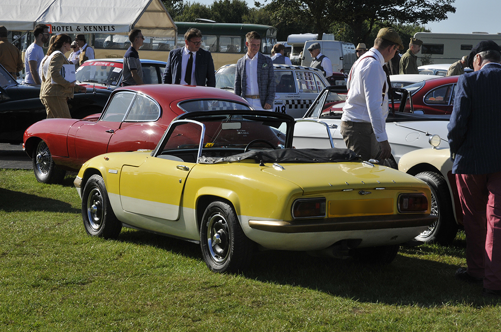

Just to be sure this is the kind of door fit problem we're talking about, right? -

Yes Stuart, that's the same problem I have although not quite as severe as in your picture. The door fits at the front and around the latch but kicks out at the rear bottom of the door. I'm looking for a recommended glassfibre specialist to reduce the width of the door to correct the fit.

I know a cheap and easy way to get the fitment close
Mine is now perfect actually
Your yellow sprint looks about the same as mine was
Mine is now perfect actually.
Don't keep us waiting! I'm about to fit my doors.
