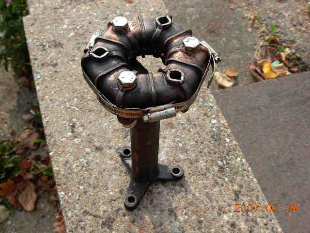

The left side of the picture below shows the two rotoflex's that were removed from the car. The one on the right is the "new" one that came with the car. All three are from different companies and different designs. The 'new" one is a smaller diameter. I guess I need to buy all new couplings. Apparently, I have to change my 30 year old tires too.

Tony Rudd in his book 'It was fun' mentions that in period the item with the highest number of warranty claims on the Elan was the rotoflex couplings.
If you search the forum, there are threads with pictures of strange mangled areas around the diff where a driveshaft has whipped around after the rotoflex has failed. If you are lucky, you can bring the car to a halt before the driveshaft wedges against the frame and locks the rear wheel.
Looking at your pictures, you have one 'pre-sprint' rotoflex without the metal interleaving plates (that has failed), one 'post-sprint' rotoflex with interleaving plates that is intact (edit: on closer inspection, it appears to be delaminating), and a replacement vintage rotoflex that is also 'pre-sprint'.
Your call, but were it me, I would show all the rotoflexes the bin, and buy CV joint replacements. The rotoflex don't 'fail safe', and they have a well documented history of failing.

Hi,
If I'm understanding the photo correctly, you've had a mixture of rotoflex on the car, the top one is the later "sprint" version and the broken lower one is the original type first fitted to the early Elans. Also, IIRC, to Hillman Imps to transmit their massive 40bhp to the rear wheels....
The mixture would make me suspicious of the maintenance history so I'd replace the complete set, both sides and keep any good ones as spares. I'd also do the tyres because after standing in one spot for 30yrs they may well have deformed slightly. I'd probably do the drivetrain first and if the tyres held pressure/no cracking then I'd drive the car round the block a few times and make a "to do" list, but even then the tyres would be somewhere on the list.
I guess this is the time to consider alternative drivetrains. When I resurrected my Elan from a long term slumber the rotoflex looked ok but I decided to change it for a CV system. More expensive for sure, but hopefully a longer term solution although to be honest I'd driven with the donuts for years with no real issues other than wear/tear.
