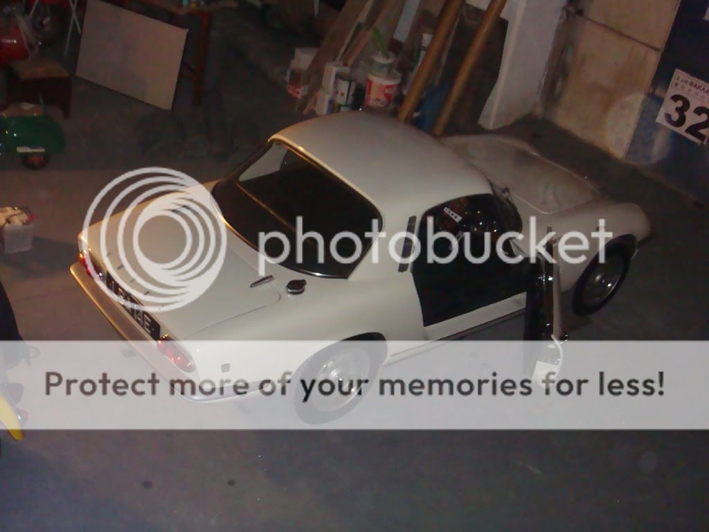

Latest update?
Got back from the regularity rally this weekend!
Car is great! This was the longest I?ve ever driven an elan and I loved it! In total we did about 600 miles.
Before the off we had some problems?
1. Webbers need tuning as they are running rich, this results in constant banging from the exhaust when I lift the throttle. This will be cured today at a specialist.
2. I changed the battery but as the car has a generator it does not charge well. Is that correct? Should I change to an alternator instead?
3. Water temp gauche doesn?t work.
4. Ignition key lock isn?t stable (turns round and round) and when the car is on I can easily take it out without the car turning off. Same for the glove box lock
5. The front LH sidelight (clear) lens fell off somewhere.
During the rally:
1. The exhaust was always scarping the ground on rough surfaces
2. LH window stuck closed and later worked its way half open
3. Finally, my own stupid fault, in pressing the boot lid down to make it lock I made a hairline crack across the ?T? of the LOTUS logo!!!!!!
4. It consumed very little oil.
All in all though I LOVE the car!!!! It is my first proper classic and I am amazed by its drivability, handling, and compactness!
and finally... some pictures!
During the rally:

An attempt at some 'answers' embedded in your post below...
GreekS1 wrote:Before the off we had some problems?
Peter - I have an alternator and have never (yet) had electrical problems other than ones related to bad earths.
Peter - Is it connected to the sender (at the thermostat housing on the passenger side of the engine)?
Peter - Hmm. I know that my iginition lock only loosly holds on to the ignition barrel. When I have the panelling under teh steering wheel off It is VERY easy to disconnect one from the other....
Peter - If you know the route......
During the rally:
Peter - I had this problem all teh time, even when changing to Protech Adjustable front shocks and springs. BUT...I had to change my shocks recently and got some Tony Thompsons Fast Road shocks with springs from Sue Miller. The rates and damping is specifically for the Elan (and +2) and now teh car very rarely bottoms out....same height settings etc.
And....our roads in Ireland are a good match for poor condition to some of yours if not worse
On top of that I live near a town called Athlone.....-> Athleon?
Peter - On my list of things to do is a lazy driver's side window. It may be worth looking at the earthing. I'll probably put relays in to bring cleaner power to the window motor.
Peter - You should see my car
Peter - Same here.....and what oil it does consume is from the breather pipe....becuase STUPID me pushed pushed out the gauze from the breather pipe when rebuilding the engine 10,000 milea ago....must rectify this....
Peter - I feel your joy
