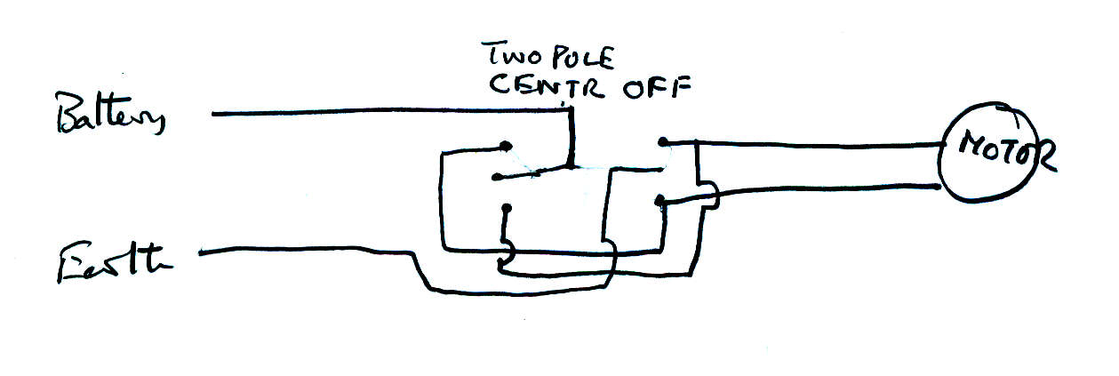

Unfortunately the specific detail of the relaying method described by GalwayLotus wont work because the basic wiring of the window motors is as follows:
The motor case is earthed (black wire) as a safety/anti-radio-interference measure but is not part of the activation circuit.
There is no power on the two green wires normally. To drive it one way there is +12v on one green wire (call it wire A) and the other (call it wire B) is earthed via the switch, to drive it the other way Wire A is earthed and wire B has +12volts.
It isn't clear if that can be done at all with single pole relays, so you might end up needing TWO DOUBLE-pole relays per window.
You will need a circuit like this:
http://www.datahighways.co.uk/photos/el ... elayed.jpg
Be mighty careful to avoid closing both relays at the same time as it will put a dead short across the battery & blow your fuse.
<later 13/4/13> I have removed that circuit from display, though you can still view it by clicking the link, because there is a much safer circuit shown in the messages below.

Tony,
This is how I did the window conversion to relays. You will need two relays per window with the following connections: 30, 85, 86, 87 and 87a.
Follow this procedure per door:
30: Main power out of the relay to power motor. One to the up side of the motor and one to the down. (trial and error will figure that one out).
85: Up control signal from the window switch to the up relay and down control signal from the window switch to the down relay. (These wires are the ones that power the motors pre modification).
86 & 87a: These should all be bussed together and go to earth. The earth wire that presently goes to the motor case should be a suitable earthing point.
87: Power to the relays. I used a thicker wire for this. I took a feed from the main power into the car (thick brown/blue wire, part of main loom where it connects to the interior loom) located above passenger's (L/H seat) knees. This is unswitched and unfused. I then ran this single feed to a fuse box (two fuses) that I attached to the underside of the horizontal part of the firewall above the passenger's knees. Two 10 amp fuses and an individual feed to each door completes the power supply.
My doors have speaker holes cut into them, so I was able to gain access to the inside of the doors to wire up the relays and then mount them inside and up out of any water that might get inside the doors.
Colin.

For those of us who prefer diagrams to descriptions, this is the circuit that Colin describes.
It is better than my draft circuit above because it uses cheaper single pole changeover relays and does not short-circuit if both relays are closed at the same time.
